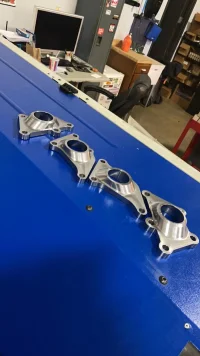

Almost done with my twin big turbo custom fab job. Went with twin Xona Rotor Turbos. Mounted in same stock location for sleeper look. Custom fab flanges, manifolds, compressor housings, turbine housings. Throttle body is rotated 180 degrees to make room for the AC lines. From here we are off to the tuners. Max HP is well over 900 but not looking to blow the block. Only looking for 620-650 whp made nice and reliably all the time. Looking forward to getting my baby back!! The fab work is being made into a kit by WOR Fabrications in Racine, WI and he will have exclusive rights for those of you looking to purchase a complete turbo kit for yourselves soon.
