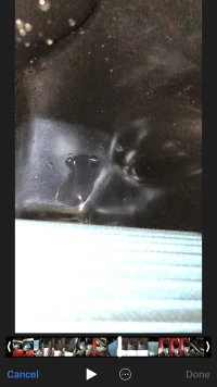

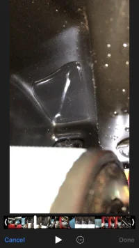

I don’t know how to upload a video...says too large. Anyway, drive through moderate rain for about 40 minutes as well as let it sit outside a few hours.
Decent amount of water pooled.
My foam weatherstripping attempt failed. Wouldn’t stick and I didn’t want to risk that coming lose in the engine bay.
I’ll just dremel a hole.

Wow wtf to say the least just watched your video and you could literally put a goldfish at the bottom and he would live ... that’s a lot of water lol your filter even looked wet like it was sucking water .... that’s no good man I know you are being a good sport and not freaking out but I am defenetely going to open my everytime it rains and look for that ... that’s sucks man ... I wonder if you suck enough water ot can cause issues ..

First off, the filters don't sit in the bottom of the cover. I think everyone is forgetting that kn, injen, diy.. all except JT have an exposed filter. Rain water always gets in the engine bay when it rains, so it isn't hurting the car. You will 100% not hydrolock for that tiny bit sitting in the bottom. I'm telling you from experience. We tried to blow up a car this way. Literally spraying a hose at an exposed filter, while revving the shit out of it for 10 minutes.

The amount of water that leaks into the air filter area is not enough to hydrolock an engine, you'll need lots more than that. More importantly is how this water will affect the filter media, I know the filters are designed to be washed and reused, however with water getting in every time it rains or the car is washed you have that dirty water dripping onto the filter, also I don't know if these filter are dry filters or oiled, if they are oiled then the service interval should be shortened.
