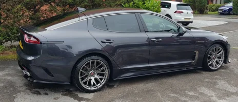

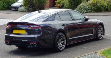

Been meaning to post some pics for a while.
Here is my 2018, Diesel Stinger. In Panthera Metal with Maxton Design kit and Quad exhaust tips on rear valance. Diesel only have tips on right hand side as standard.
Wheels are 19 x 8.5 ET40 (Fr) and 19 x 9.5 ET40 (Rr). running 225 / 40 and 255 / 35 tyres.
I am happy with the stance and the way they fill the arches. Will look for wider rubber when these are worn. They came as a package, hence going with these sizes initially. Hope you like.Stinger 1.webpStinger2.webpStinger3.webpStinger4.webp
Looks great. Yes when time go up a tire size or two. Does look really clean though. Nice job.
