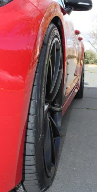

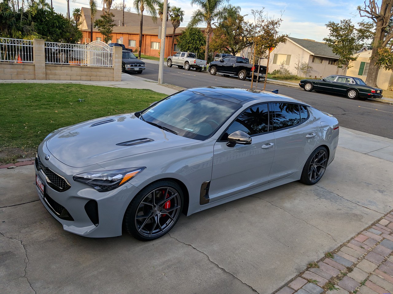

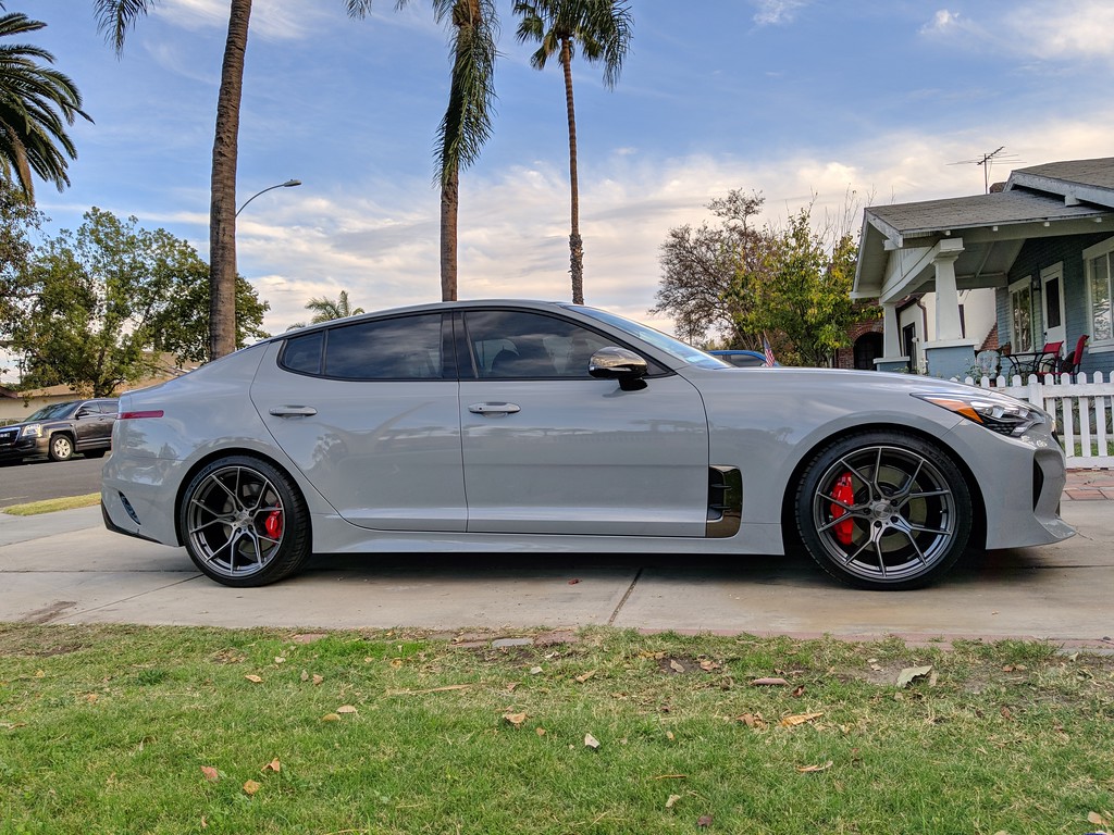

AWD?Drop was prob just a little more than an inch. Ride feels same as stock to me. Will post more pics later to give you a better idea on the drop.

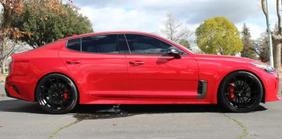

Looks fabulous!!Went with a 255/35r20 square set-up on 20x9 KMC Spin wheels, offset is 38. Car is lowered on Eibach springs.
That looks really good. Good balance too of wheel thickness and offset in the front looks flush.Went with a 255/35r20 square set-up on 20x9 KMC Spin wheels, offset is 38. Car is lowered on Eibach springs.
Nope, no issues. Its the same all the way around 255/35r20 on all four. Went with that just so I can rotate them. Might go wider in the rear with the next set of tires.Looks great. Any issues on the front with rubbing etc? What size are you running on the rear?
Why go wider in the rear? That would defeat the purpose of square setup right?Nope, no issues. Its the same all the way around 255/35r20 on all four. Went with that just so I can rotate them. Might go wider in the rear with the next set of tires.
Yeah it would, I'm talking more down the road after the Nittos are burnt up lol. Still have the OEM wheels too so will probably do a wider than stock staggered setup with those.Why go wider in the rear? That would defeat the purpose of square setup right?
Awesome setup my friend...
Can you tell if your Steering effort got a bit heavier/stiffer with the square tire setup?
Did it increase slightly, a fair bit, or a quite noticeable amount?
What tires are you running?
Thanks!
Thank you and good question, initially, I don't feel a major difference however I haven't had the chance to really put this setup through its paces yet. Should have some feedback after this week. Will report back.Awesome setup my friend...
Thanks!
Man that looks really nice. Just about perfectWent with a 255/35r20 square set-up on 20x9 KMC Spin wheels, offset is 38. Car is lowered on Eibach springs.
Thank you!!Man that looks really nice. Just about perfect
AWD OR RWD. And are you concerned about the diameter difference affecting the drive systems?Thank you!!
AWD. Honestly, not really. The "unsprung weight" is essentially the same. The speedometer is off by about 2mph and shouldn't affect the ABS system but in the event it does. I'll cross that bridge when I get there. Plan on having my shop look at it every few weeks at first to see if there is any excessive wear any where. Will update if I run into any issues.AWD OR RWD. And are you concerned about the diameter difference affecting the drive systems?

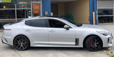

I just went through all the post of wheels to find your car. Just had to have another look at it.Let's see if this works

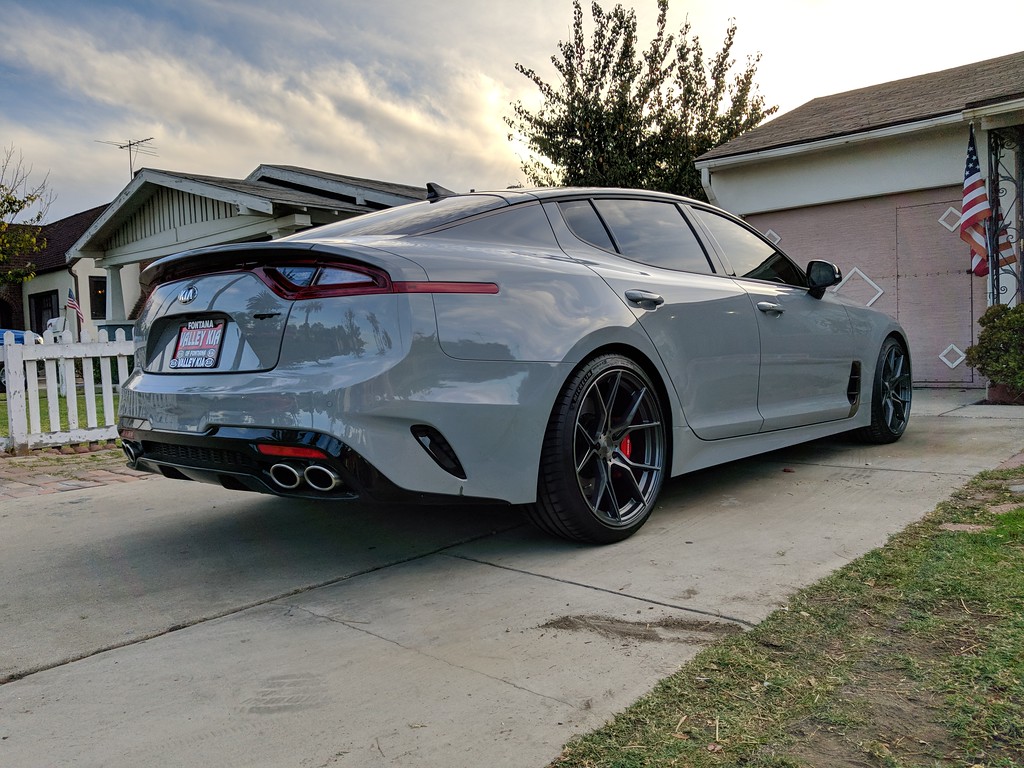

Stance wheels Sf07 brushed tinted gunmetal
19's 8.5 front 9.5 rear
