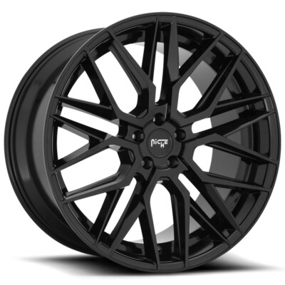

I want some 19 inch black wheels. I've found some 19x8.5 niche gamma wheels but am unsure if they will fit the front. Do they need to be 19x8?

What is the offset? My TSW 8.5 front wheels clear, with a 40 offset. Brand of wheel, even with the same offset, can vary as per clearance, but not by much I understand. You could always ask the pros (Wheel Werks knows all about that clearance stuff).

35MM
That should clear the suspension easily. I don't think that 5mm more clearance is going to move the tire in relation to the fender. But I would be asking the pros to be sure. :thumbup:
It should clear with those specs. There’s an example on fitment industries if you search.
19x8.5 +35 will work fine all around but if you're planning on staying staggered you might want some wider rears.

Currently, I have the same specs for the front 19X8.5 +35 with same oem tire size. Changing out front tires to 245/40/19 to upgrade soon so you have some wiggle room with tire sizes.
So does anyone know if 19x10's with an offset of +40 would fit in the front?

^^^Tyro here: but those both look extreme. I'm guessing the 8.5 with 20 offset will hit the fenders. And I've never read of anyone using a 10" wide wheel in front: would also smack into the fenders if it cleared the suspension at all.

Biggest wheel up front I have a record of is 9.5in wide. Here's a link to that post Aftermarket Wheels
Also link to the spreadsheet of the known good fitments Stinger Wheel Tire Options

They will fit easily with proper offset
My daughter has 20x9 on front and 20x10 on back
