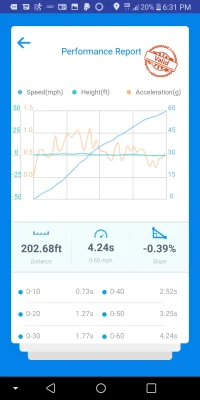

and a waft of truth flows thru the ops post, while fast, worlds apart.Here is my dragy 0-60 4.23. OBD fusion was about a half second optimistic.
Ran 4.23 on the same piece of road using auto hold and launch control. So LC is still rather worthless.
Ran a 4.15 but a little too much slope to get the valid rating. Dragy does vary by more than 100% on its slope readings on the same exact piece of road.
The place i ran a 4.15 i also ran a few 4.24s and 4.25s so i think a 4.1X is certainly commimg.
