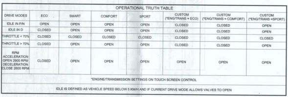

I have checked my MY22 - and the flap on the exhaust is:
  • open when the car is off
  • closed at idle as soon as I turn the car on (defaulting to comfort mode)
  • closed at idle if I switch to Sport mode
  • closed at idle if I go from park to drive in any of the above modes
  • will open if I rev the engine in any of the above modes
Makes me think that Australian MY22 does not conform to this previous post about "Operational Truth"

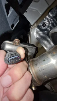

I wish that we could remove a fuse / relay (like in a Commodore / HSV) and get full time open valves. The only way I have seen to do that on a Stinger is this (if it works) ... which leaves us with exposed electrical connections that will get filled with mud and grit and cause other problems.

I’m tempted to try the cable unplug on the valves to see how it sounds and operates until I can find a good aftermarket exhaust for the 2022 - I’m concerned that the aftermarket ones won’t line up with the standard tips and I’m not enthused by buying aftermarket tips from Ali Baba as I like the standard look already. I’m hoping Borla or MBRP may release a V2 exhaust for the 2022 which can utilise the standard exhaust valves for loud and quiet modes.
As for dirt or grit getting into the connections I’m wondering if it would be relatively easy to use electrical tape to keep them taped up and cable tie to the side safely. Will need to get under the car on the weekend and see what options there are
We have different suspension in Australia - so maybe also have different exhaust settings. Also keep in mind that the operational truth clipping was from another members post from years gone by - and there have probably been multiple iterations of exhaust logic here (and possibly internationally) since then.
When I look at the 2022 Genesis G70 video clip - his car clearly operates the same as my MY22. Valve immediately closes on startup.
As for just unplugging and taping up the ends - there are a couple of reasons why this might not be a good idea. One is that it is pretty tight and fiddly under there, and getting tape on all the right spots may be tricky. The other is that if you just disconnect, they talk about that throwing a "soft code" to the engine management system (so not a CEL - but a logged event that the dealer will see when they service the car). To avoid that - you need to buy the Exhaust Valve Delete Modules and Blanking Connectors (which appear to send a signal back mimmicking as if you had never unplugged anything). There seems to be two main types of these - 3 pin and 4 pin. From the video clip - we likely have 3 pin - so something like these:

just FYI, I replaced my exhaust on my 22 and I did not re-use the factory connectors for the valves. I just disconnected them and there is no CEL issue at all or any indication that they are unplugged. I just tied them up back in that area.
Not sure if that is your concern or you just want to plug the ends for the sake of it.
I know somebody mentioned some sort of CEL issue or something if they are unplugged, but maybe it is just pre-22 model years or something. Not sure, but my 22 has no problems.
I have the MY22 version of the JunBL EVC and I had a similar question. I reached out to David at K8 as well as JunBL on Facebook and was told that I needed to use the connectors provided with the kit. The plugs were probably 95% similar in but did not snap in, and also did not have enough voltage or something because they could not actuate the valve of the JunBL exhaust.
