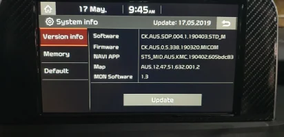

FYI; It works successfully when loaded on a fresh new SD card (16gb). It even updated fine while driving.
(My orig Kia SD map card is in the glovebox, as a spare map)
In the dash where it says SD card , lift up the tab and remove the card. I strongly recommend you let dealer do it.
Why? It is very easy and Kia recommend to do it yourself. It's the whole reason why they have the website and provide easy to follow instructions.
The dealer needs access and if you register your vin then he can’t get the downloads.
I wouldn't go dealer just for a map update so much easier to DIY.
It's pretty easy to do it yourself, I had my 3000km service the other day the dealer didn't have a clue about the map update or the update web site, I guess it comes down to the quality of the dealer. The service manager is a good bloke but the kids in the service centre couldn't tie shoe laces properly I'm sure.
Register on the WEB site.
Download and run the SUM application.
SD card in PC (will format the card so I just bought a new one for $9.98 from officeworks) Keep the original as a spare.
Software downloads via SUM application to card.
Optional - Take a copy of the card as is before you use it in the car.
Put card in car.
Turn on ignition follow prompts on screen.
Easy as.
You can backup the content on the card before the update in the car, and use the same code base from the card on any other 16GB SD card to update as many cars as you like. Just need one card per car.
There is absolutely no security associated with the card/code base or VIN number.
But once you use the card to update a car, it cannot update another car.

The upgrade is super easy. I was 2 versions behind and just purchases in March so I called Kia and they shipped me the update for free instead of paying $145 US for it. Takes about an hour for the update to apply.
You would need to purchase and download or have them mail you the SD car with the Canadian Region Map Data.
