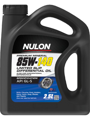

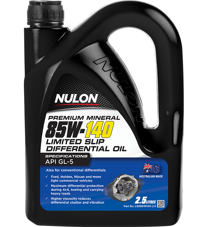

Howdy team... I have always had quick street cars and over serviced them myself, as always this forum has a plethora of information so anyway, what are your thoughts on this oil for my RWD?
I ask because KIA gave me that blank stare when i asked for SK HK JL Syn LSD Gear Oil 75W85 PLUS" with a part number of 02100-00121 for my car a few weeks ago.
I want to change my oil while i am fitting the BMS diff brace ;)
