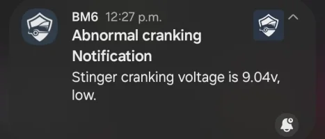

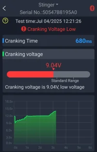

I went on another vacation! This time 39 days between starts of my 2018 Stinger.. (May 26 - July 4)
This OEM battery is a beast.
I half expected it not to start..
I thought surely, after sitting for 39 days, this would be the end of it.
Battery voltage was 12.1 before turning the ignition on.
I'm slowly reaching the end of its long drawn out AGM life... I'm not too confident it'll last all winter.
But I like to live dangerously, so I will find out the hard way.

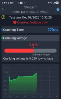

2018 here too. I have no idea what the return stats would be. But when I forget to turn off ISG, and pull into the carport and put it in "P" it shuts off and turns back on again. Which is annoying of course, but the upside is that I know my battery is still strong.
I wouldn't risk it much further. if you fry the alternator, replacement is difficult to put it kindly. replacing a battery a few months before it dies is just cheap insurance at this point on a 7 year old battery.
eight year old battery in two months. You think my battery is just going to go *kaput* without any warning signs?

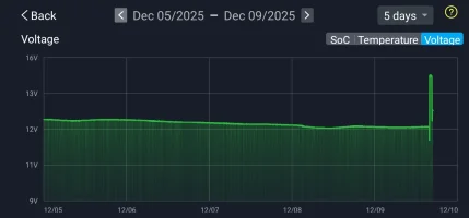

I'll just continue to keep an eye on my battery, cranking speed is actually quite good.
I do measure the voltage and temperature, every 2 minutes.

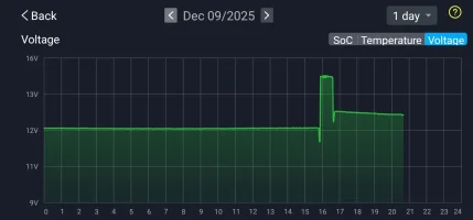

Here is today's voltage.
And here's the last 5 days
