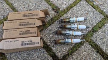

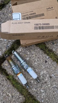

Completed the replacement of the original spark plugs with factory OEM.

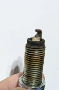

Hard to tell condition of old plugs with the blocks in the background. Take a pic of them against a solid (preferably white) background. Normally the condition of the tips and surrounding insulator is an indicator of condition.
Color looks adequate for 24K miles. Would think they'd be a lighter color. Suppose with the turbo this is expected. Can't tell condition of tips.

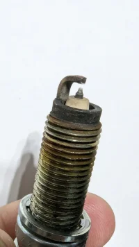

Here are additional pics. With all my vehicles that I've owned that had turbo engines, I usually replace them earlier as I tend to keep my vehicles longer. Per the Kia Stinger manual, they recommended changing out the spark plugs every 48k miles. Changing out them earlier, for me, gives me peace of mind.... easy 15mins.
Those old plugs look to be in excellent form. Electrodes look relatively sharp and insulators very clean.
