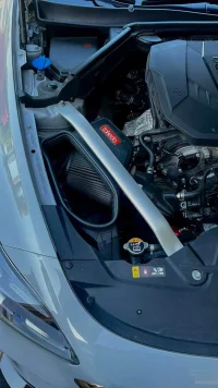

R and d intake for the 2.5 *not my picture* you won't find this anywhere. I want it tho
Looks superb....Where do you get this?
You can't yet. Someone is trading it on fb marketplace for stock. ImO it needs clear lexon sealing off the top. But it's nice. It's made by Afe. It's in research and development so they aren't selling yet. I really want one.
ITS HERE! You can now preorder AFE Takeda sealed CAI for the 2022-2023 Kia Stinger GT-Line 2.5L turbo! They will be send out early Feb. Also they will have an open concept cai available for preorder next week that will be sent out March... (im kinda happy they beat Injen, cause i wanted a sealed unit for preformance) its on sale from $500 to $423 and i found a 10% coupon if u sign up to thier email letter and it ended up costing $380 !!!

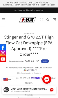

Just found out that IMR America sell the down pipe for a 2.5T Stinger and G70
Hoping to see dyno charts and sound video
Anyone preordering?
Interesting... seems like now that G70 has finally switched to 2.5T, the aftermarket support is picking up steam.
I put a pre-order in for the Takeda CAI over the holidays.
