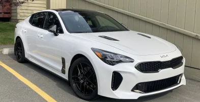

18" wheels, I presume, since you are showing this example here. Did you have to use spacers in front? What offset? If I went square, that is exactly what I would try for, 255 on 18" wheels.

Wheels are 18" squared from a Genesis g70 in gunmetal grey. I have a awd base gt but they'll work just fine on your gt2.
I think the word is that most 18" wheels fit. I had a set, JNC 026 18 x 8 et 35, where the valve Stem bump hits outside of caliper. There valve stem is strangely located in the center of the rim, so I would avoid this configuration. I now use XXR 860 18 x 8.5 and the work fine.
Thanks. 34 offset is the OEM offset for the 8" front wheels. So, running 8.5" wide at 34 offset with a 255 tire has to be CLOSE. From what I've read, I'd expect that setup to rub somewhere.

I’ve inspected while changing wheels for winter and found no rub, I used mirrors during initial and turning wheels lock to lock to see, but no rub. It is tight near the strut, but there’s at least 5mm of clearance. I’ll verify the offset.
I still haven't raced it yet, the other car is too much fun and I haven't had a wet day on a race-day yet. I do tend to push my cars pretty hard, so checking that strut for any contact marks and the wheel well were pretty important for monitoring, possibly putting spacers in, but like I said, no contact marks. I think I took a picture and put it here somewhere.
