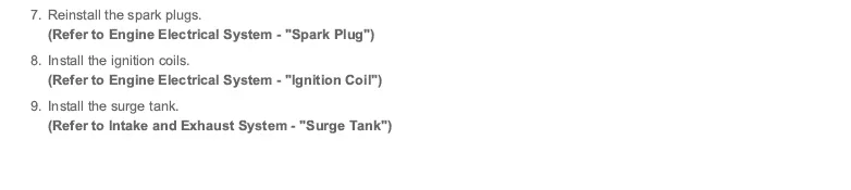

Given the annoyances involved in getting to the spark plugs on the v6, I bet 3 hours is the book time. The book procedure probably says to pull the intake.

Don't need to remove the surge tank when doing the test. Disconnect spark plugs and you good to go. That's what I did on mine. Oh and unplug the fuel wires. Took under half an hour
