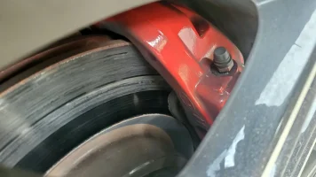

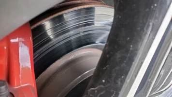

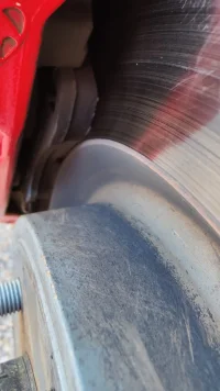

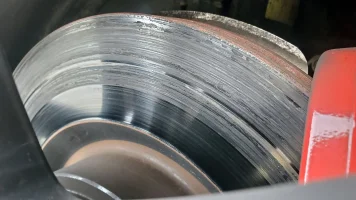

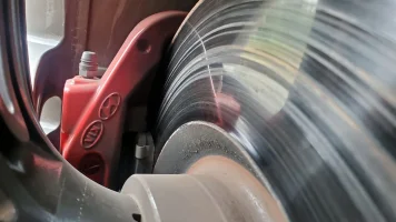

If I can get a handful of track days out of them then it'll be worth it, considering street pads wear out after just 1 and I'd have to buy a new set anyway.The Bluestuff has been through 3 track events and quite a few AutoXs so far. There was a visible amount of wear on the Bluestuff after the first full Track Day, so I thought they might wear out pretty fast. Since then, wear rate hasn't been as high as I originally thought.

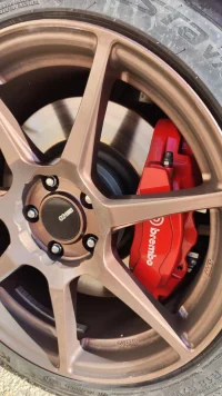

Keep me posted on that, I'm curious if it's just my car, or common for stingers to have uneven pad wear 3 different ways. Do your stingers have the Brembo calipers?The 2.0T Stinger is due for brake fluid flush, as soon as this hellishly hot weather lets up a bit. I'll get a chance to pull the pads for a closer inspection.

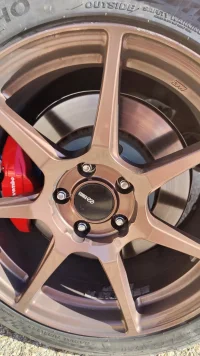

More sidewall is what I'm looking for; a smoother ride on public roads. Though I have no idea what effect going from the stock 3.5" sidewall to 4.3" will have. Might be too much, or not enough to notice or be worth the hassle.245/45R18 square would work too, although the sidewalls are gonna be quite a bit taller than your stock 19's.
I had the idea of throwing a square tire setup on the staggered OEM rims (235/40r19 should fit both the 8.0 and 8.5 widths) and timing a tire rotation just right so you only have to do it once before the tires wear out.
I figure 245 would compromise steering too much at the front, while going down to 235 for the rear should still be ok with AWD.
