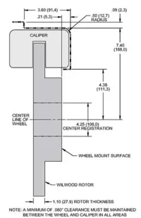

Yeah, TSW probably had a certain car in mind when they built those wheels and didn’t take big brakes into consideration.
They have drawings like this to build around. AEEC006E-3AB5-4947-A282-2518CDFCE330.jpeg
I went with a company that builds the wheels to the millimeter to get them exactly where I wanted.
I think Stance, Forgestar, and lots of the fully Forged wheel companies like HRE, BC Forged, etc build to order like this and ensure caliper clearance.

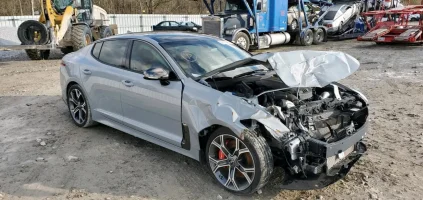

So I put my wheels on today. I ended up having to run a 10mm hub centric spacer in the front because the wheels were not concave enough to clear the brakes I was able to get around 9 turns on the extended lug nuts . Should this be ok there wasn’t any vibrations while test driving the car. F2AFB3F9-A79C-4C8C-BB45-44484FB9CCC7.webp
So I put my wheels on today. I ended up having to run a 10mm hub centric spacer in the front because the wheels were not concave enough to clear the brakes I was able to get around 9 turns on the extended lug nuts . Should this be ok there wasn’t any vibrations while test driving the car. View attachment 56116
They are very pretty. I recall reading here recently that the minimum turn is five to secure the wheel. But if I remember correctly, that doesn't mean it's true, unless it is. Hah. :P
