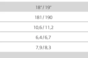

For gas milage, here is the official consumption difference for the EU 2.0 GT Line in Litres / 100 km.
Top to bottom: Wheel size, CO2 emissions, Fuel Urban, Fuel Extra urban, Fuel Mixed.
