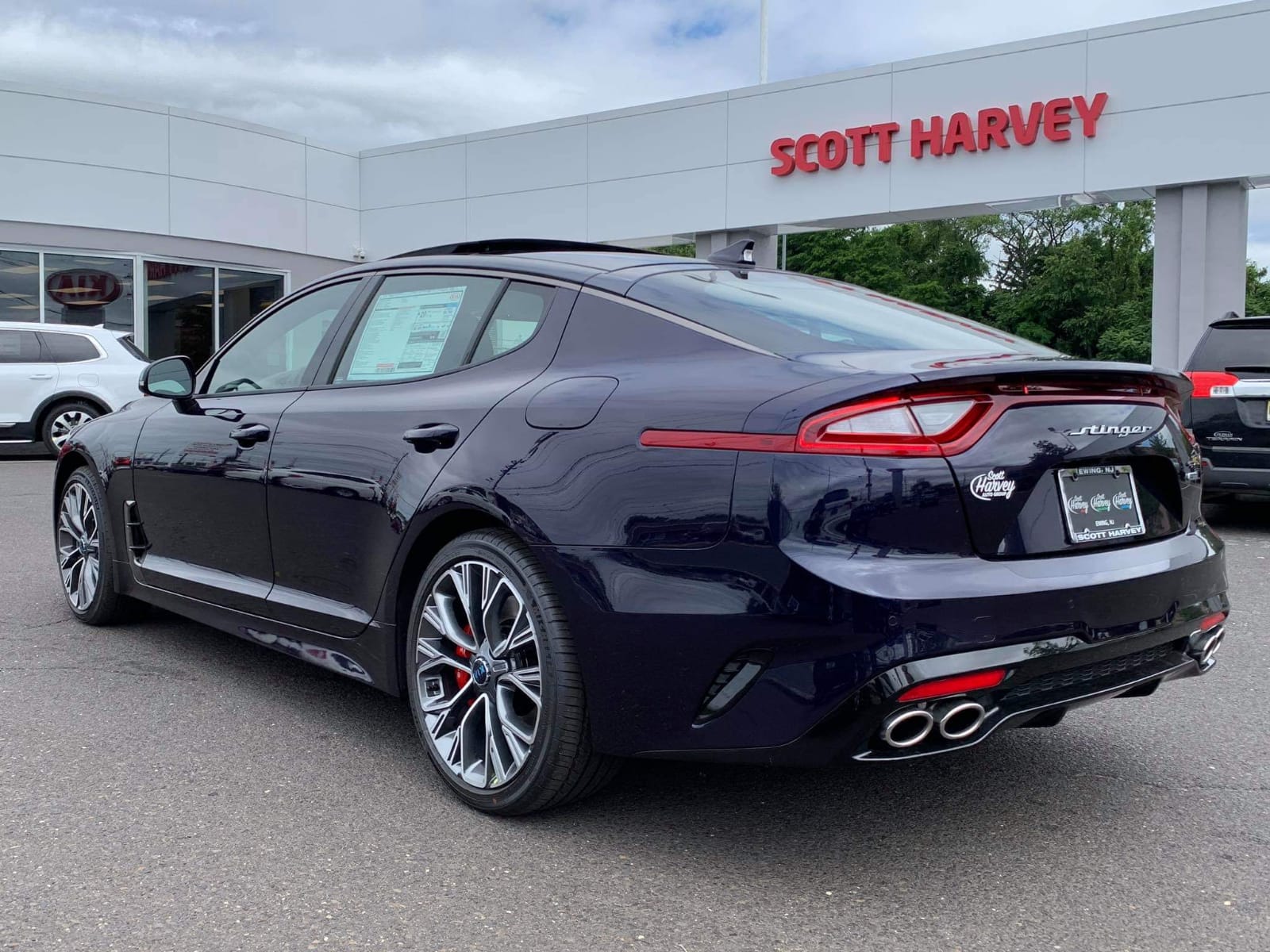

Kia Motors America Quietly Launched Stinger GT Indigo Edition​
by Kevin RooneyJun 18, 2020All News, Kia, USA
Deep Chroma Blue, unique wheel design, all-brown interior, and drift mode combine to make this the rarest Stinger yet. Kia Motors America just quietly delivered the first batch of a new special edition run of the Kia Stinger GT............................
Those wheels were on the 2019 "20th Anniversary" Stinger in Canada as well2019-Kia-Stinger-GT-Side-Profile.webp
