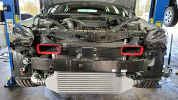

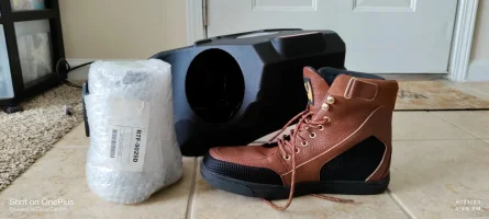

AFE cold air intakes paired with ram air ducts would be your best bet. They're fully enclosed with options for either dry or oiled filters.

I’m running aFe Power system with dry filters, no engine mods & factory air ducting, the car still runs quiet but it is definitely more responsive, the engine breaths better & under acceleration it just wants to keep on giving.
They are fully enclosed housings & will assist in reducing radiant heat from the engine bay, they are also well constructed & look good.
If you end up running the Afe intakes I recommend getting the pre-filter covers too. It pays back dividends when cleaning.
