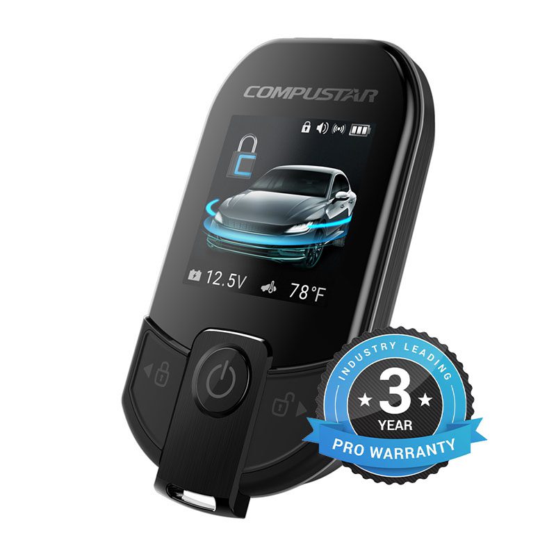

Okay, I was looking at the RF-P2WT13-SF, which is Canada only. The USA model is RFX-P2WT13-SF.Suggestion
With
Advanced security sensors
Dual-stage shock sensors
Tilt/towing sensor
Glass-break sensor
Door/hood/trunk monitoring
I had the much older compustar 2wFM900 (top of line at the time) on my previous car.Okay, I was looking at the RF-P2WT13-SF, which is Canada only. The USA model is RFX-P2WT13-SF.
Does it plug into OBDII port? I have a JB4 plugged there. Do you have this security system installed?
I'd like to know more about what factory systems it replaces or overrides and how well it works with them. Are there videos or documents that explain what I'd be getting myself into with the installation?
So are you in the same situation, where if your rear door windows are smashed, no alarm?I had the much older compustar 2wFM900 (top of line at the time) on my previous car.
No it certainly does not plug into the OBD2 port. It is not in any way plug and play.
It's a very good also system, plus remote starter, possibly the best.
Once my free 5 years of Kia connect is expired, this would be the system of choice for my for my remote starter/alarm.
