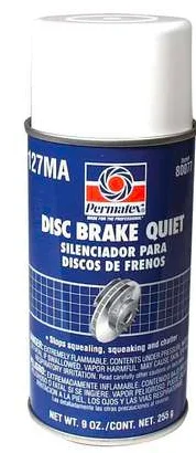

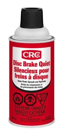

I lightly grease the sides and I spray the back with the red sticky spray, forgot what it's called. no noise issues here.
this type of stuff?
I put a very light coat on the pad backing, like a wipe with my finger and a touch on the pad contact area of the caliper. A very thin coat.

If the surfaces are exposed, grease won't stay long enough to help much. In fact, too much of it will just end up attracting dust, form grime, and wear out the very surface(s) you're trying to protect. You're much better off cleaning them thoroughly before reassembly.
You can grease the pins, if you're so inclined. Rub a very small amount all along the shaft of the pin, then wipe all of it off. What that does is pack the microscopic pores of the metal with tiny pockets of grease. The pins will feel slicker to the touch, even with clean fingers, but nothing enough for dust to adhere to. This basically helps reassembly and the initial movement with brand new pads, when repeated braking action will sort out alignment of all the parts relative to each other. After a while heat produced from normal braking will evaporate any remaing surface film of grease from all the exposed parts. By then, the pads should have already settled into position and will move very little after that.
Compound on the back of the pads are unnecessary. If the goal is to quiet the brakes and dampen vibration, there are typically already anti-rattle clips and mass dampeners (those goofy looking ears) to reduced both low and high frequency vibration that cause brake VNH. Yeah, auto parts store will be all too glad to sell you stuff that supposedly help. Hey... $1.29 that does absolutely nothing is a great upsell and profit margin adder.
