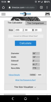

There's a good calculator to match the revolutions per mile so you don't goof your speedometer.
The rear 255/35/19 are 775 rev/mi. To match that, 255/30/20 comes out exactly even. Lots of playing here if you wanna get clever with the size changes.

Can't say how much it would annoy you but just for the numbers, here's the comparo for the rear.
The fronts a little more different at +6.5% on overall size and speedo error. Fixable if you care but not the easiest. I'm not super knowledgeable on rim fitment but going up 2-2.5" on the rear is pretty chonky.
