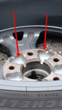

I did not measure with any degree of accuracy, but it appeared to my eye that my '18 stinger wheels had enough pocket to accomodate 15mm spacers.
I used 20mm spacers so it easily fit.
Eibach may be being a little conservative with their safety margin - better safe than sorry.
Correcting this post...
I have now measure the OEM studs length protrusion beyond the spacer, and it will indeed NOT fit with anything less than a 20mm spacer (stock wheels and stock studs).
The studs protrude very nearly 10.83mm beyond my 20mm spacers, and the pocket depth on my OEM rims is very nearly 12.42mm - leaving only 1.59mm of clearance (0.063")
Anything less than a 20mm spacer would need the have the studs trimmed shorter, or replaced with Ionger studs meant for spacers that do not have integrated studs
