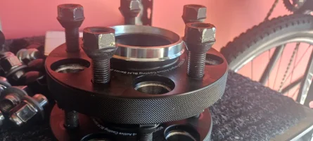

Confirmed - this is with 20mm spacers.
So that's 10.83mm of stock stud extension past a 20mm spacer? And 12.42mm of space in the voids on a stock wheel?
That implies that with a 10mm slip-on spacer you'd have almost 21mm minus the thickness of material on the wheel where the lug nuts mount. I don't suppose you have that measure handy?
Correct.
I do not....I did not measure that...
But I would guess that with a 10mm slip on spacer, you would not have a "comfortable" amount of stud to thread onto.
