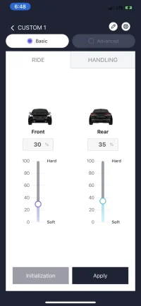

Here is a look at the App setting.
You can go Basic or Advanced, this is the look of the Basic setting.
