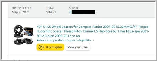

As for brand, if they are hubcentic, who cares what brand? Mine were the most economical at the time, hub-centric - they were listed for some Jeep or old ford escape/fusion.
