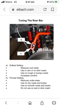

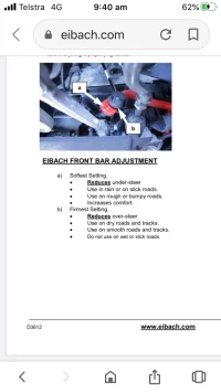

These are helpful guides.

Eibach says soft unless you are tracking the car.
