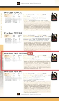

For those interest heres a copy of the TSB for the oil upgrade with friction modifier & a pics of Kia Genuine & a one of an Aussie equivalent.

I think it's important to find a suitable non-OEM oil for these diffs. I've heard ridiculous prices for the genuine oil and paying that every time the diff needs an oil change is unacceptable (particularly once these are out of warranty).
