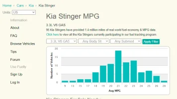

Of the 1.4 million real world miles tracked so far on 3.3L V6 turbo stingers (95 participants)....
Anything over 28 is a statistical outlier. Actually, even 28 is an outlier.
18 to 25 seem to be about the norm.
