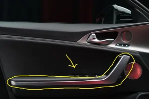

I have an issue where my leg rubbing up against the silver trim has caused the silver paint to peel off. I was wondering if there was a way to remove it so that I could sand it down and either repaint it or wrap it.
I tried looking up a guide to remove this part but couldn't find one. I've highlighted the part in question in the picture.

Guessing the screw here and a bunch of clips

Yep you guessed right! I think a wrap would hide it well, but I think it wouldn't look smooth without removing or sanding down the paint. I might be wrong though!

it's not going to be easy.
That part is heat welded (plastic) to the outboard side of the door card. I would be shocked if you can buy that part separately from the whole panel.
I suppose you could drill the welds, then reattach it using coarse screws and fender washers.
