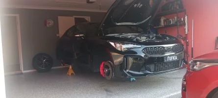

Anyone else been through this?
Obviously I am asking the rank and file that have modified their car.
Just sitting still at idle and as soon as I start the engine there is a humm and physical vibration in my steering wheel...
Doesn't matter if in Park or in Gear?
Exhaust is not touching the column...
Rack is tight on the frame...
Nothing else attached to the engine (engine mounts for example) is having an input in this issue...
I am at a complete loss??
KIA are scratching their heads, I have loosened all the bolts and dropped the rack down, did a filter and oil change while the room was there, swapped my dump pipes back out for stock incase there was an exhaust leak that was puffing on the colum shaft .. nope !
Someone else must have experienced this before or currently???
Help please
