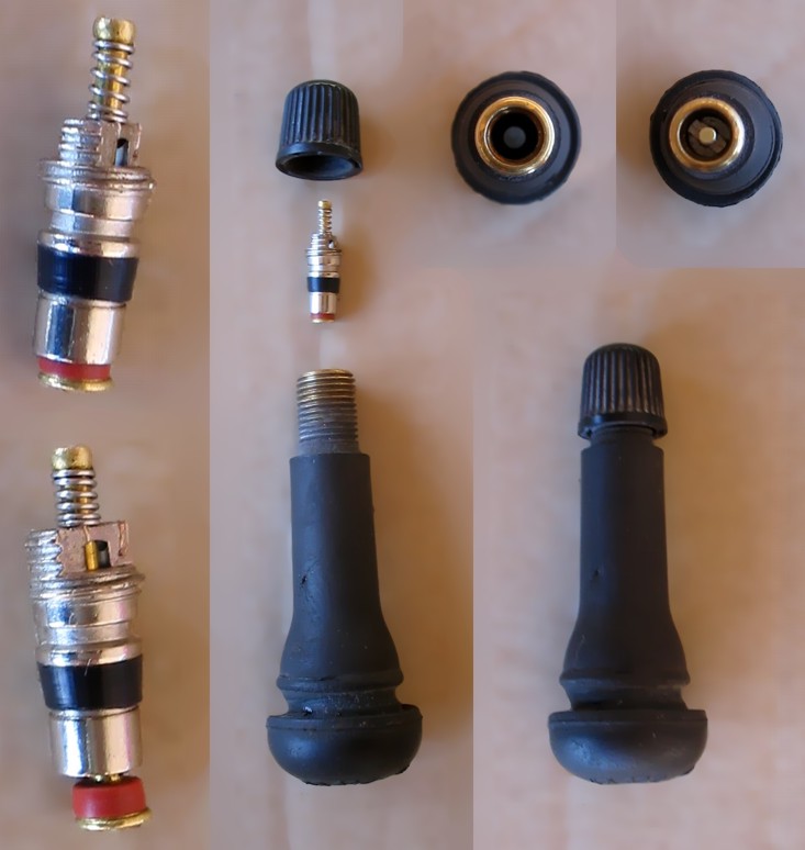

They do sell tools you can use to remove/replace/the valve core within the valve stems. Can always see if you can back it out a bit without causing them to leak. If not, and you can't get anything to work, you may have to get the valve stems replaced.

Schrader valve valve are designed such that you don't actually need to press the center pin to add air to a tire.
You only need to press the pin to remove air, or to measure the current pressure.
they are very ubiquitous, and not at all unique to Kia
I suppose it is possible someone before you added some tire sealant through the valve - and glued it shut (never heard of that occurring either)
Guess you could try replacing the core.

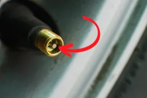

Please provide a picture of your wheels.
Apologies on the delay, I thought I had set this to email me and it didn't. I'll get some pictures uploaded in a few hours.
Difficult to tell from your picture
But doesn't look too far different than this
Here are pictures of wheel that’s needs washing lolView attachment 75163View attachment 75164
hmm.. it looks like it is similar depth.. however is it possibly bent over to the side a little? i think you are supposed to be able to fill without pushing the valve but i've had some that did and if the little push pin part was bent it wouldnt' go...
if it is all 4 that behave like that, i'd say whatever brand/version of the valvestems valves the shop used either defective or just poor quality perhaps... i've never had an issue with my personal air compressors/costco/ anywhere to top off the air..

Backing it out was ultimately the fix. I have a Park Tool VC-1 for my bicycles and was able to use it (with the help of a small adjustable wrench) to back the valve cores out. Thanks all for the help!!!
