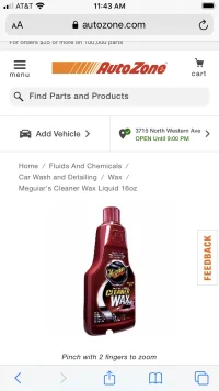

I had what looks to be the same spots and this stuff removed them in 2 seconds flat. Worth a shot!View attachment 48016
Yep, a good cleaner wax should help.. I use a griots brand cleaner wax and that got some stubborn stuff off our white car that even clay car did not remove.
If you need more. Meguirs ultimate compound. Clear safe. I use it with an orbital on stubborn water spots and scratches whenever I get a new car. Then Polish/seal/wax.
