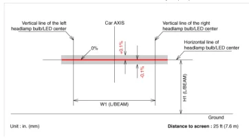

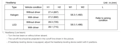

Thanks for the diagrams!
no problem
Always nice to have online references.
Once you adjust them - you will laugh at how simple it was.
