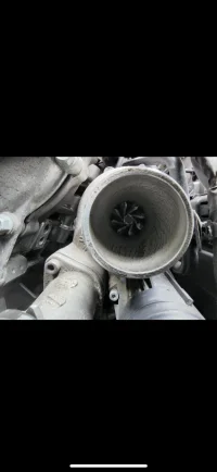

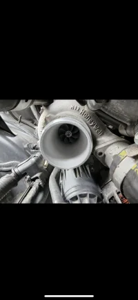

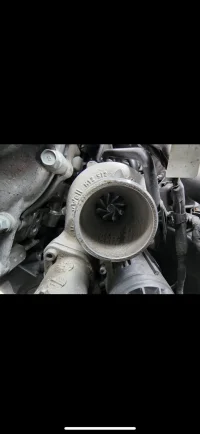

These were the pics some local guys took of my both turbos. The car still runs fine and I don’t hear any weird noises but it’s only a matter of time before they do go bad. Rather jump on this now rather than later. The blade of the turbos are dull not sharp.

Those pictures look like the car was run without air filters.
Definitely had them in there when I purchased the car and then swapped to Aem dry panel filters which I’m currently running
Makes me feel a kind of way about those AEM dry filters...
You think those caused it or could be a contributing factor ? Maybe switch back ti oem just for peace of mind and no guessing as to the cause
Aren’t the blades supposed to be sharp on though ? What else could contribute to turbo failure that I should possibly consider ?
Did the one turbo with the premature wear from poor air filtration actually fail though? Or does it work fine still?
