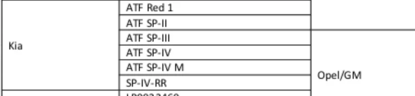

And the Valvoline Maxlife is fully compatible with RR, its not on the container its in the spec sheet.
Stinger requires 75w85 differential oil and sp-iv rr oil for transmission. RR part is important, since it is not compatible with sp-iv. Don't know if valvoline meets the specs though. Totally agree on the front diff. Total pita. I unbolted sway bar bushing brackets. Made it litle easier.
Looking at the Valvoline page, it looks like it's compatible. Multi-Vehicle (ATF) Full Synthetic Automatic Transmission Fluid - Valvoline Go to the Multi-Vehicle PI Sheet, then scroll to Kia.
