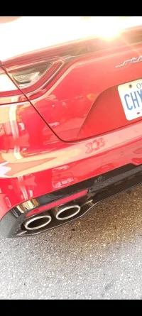

Hello all! Let me start out by saying holy cow the stinger drives very well in the winter on snow covered roads. With that being said I was trying to pull a car out of a drift and I crawled underneath front and back but did not see any obvious place to attach a tow rope. I returned to my garage and checked again but all I see is the plastic front bumper or the rear exhaust, both of which I am not pulling from. Anyone know any information about this? I would love to know to be prepared for the future.

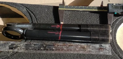

My car came with 2 x different tow loop attachments - both different thread size
Going through some pics from 2019
I was incorrect about the different threads for front and rear - they are both M24 x 2.5
1 has a noticeably more beefy shaft
At the time - I was measuring the exact tow hook license plate fitment that I wanted.

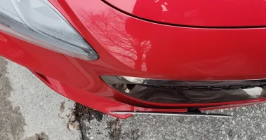

mine is currently bent because of some ass hat backing up into me and leaving... still hurts to look at but to lazy to remove
Your plate? Is that all? I'd say you got off Scott free if your tow hook plate was all that took the hit!
honestly yeah!! right under my plate, my paint got scratched up for sure but I mean it could have been wayyy worse if that license plate wasn't there.
