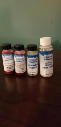

Dr. Colorchip does not ship to Canada, but PaintScratch does. I ordered my paint from them as a two stage (plus clear as well). It takes some practice and finesse due to the two stage application, but the results are night and day better than the pens.

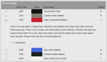

Can anyone show images or share experience with Dr Colorchip kits? Especially in HiChroma red. I've got some color chips and want to fill them. This kit looks good for the price and all of the review videos I have seen were positive.
Mainly curious b/c Dr Colorchip has you acknowledge that it may not be a 100% match to the 3-stage OEM paint:
Wondering how far off they could be? I imagine it's tough to match the pearl coat. :unsure:

I think the Stinger's colors are hard because it is tri-coat. That means rather than a more basic paint which is just color coat, then clear, it is flat base color, then a tinted "pearl" coat with the metallic flakes, then clear, that's why the single stage pens don't match. I know the Kia pens are hot garbage, but I don't think the Dr. Colorchip will be perfect, maybe just "better." I bought the tri coat kit from PaintScratch which has the base coat and tinted clear coat that you apply in that order, but it's tricky to use, I only had a near perfect match from 1 of 10 tries, but it's been way better on average than the terrible Kia pens.

As for how to apply, make sure you get enough thickness on the base color first, and apply the tinted clear coat in THIN LAYERS because if you get too much tinted clear down, it will not match the color of the surrounding paint. I suggest using a piece of plastic (I think they give you one) to do some tests before actually doing it on the car. I think the real trick is again those very light layers of tinted clear until you get it just right. It'll get darker with each layer.
