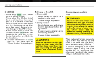

I’m planning on making a trip to Colorado with my Michelin 19” A/S and I’m curious what’s the best route to go in regards to chains.
I’ve seen in the manual it says to use Autosock fabric snow chain (and only on the rear tires)? Any experience with those and why just the rear?

also i don't know why just the rear.... everything i've seen in more generic reviews/tests, you want them on all 4 obviously so you can have steering.. the manual in mine states if you can only use 2 , use them on the rear.. otherwise all 4 1671116936742.webp

kia does not recommend rear wheels only for pre 2022 models.. .. it states in the manual only do rear only in emergencies... long term of rear only can cause damage.... but i got curious so i pulled up the 2022 MY manual.. and sure enough it does state only rear tires... but for short distances only... strange! 1671460375444.png 2022 model manual1671460574315.png
but then later on pre 2022 and post 2022 manuals states the same rear wheels only.. so... I guess even they were confused... lol... carry on. probably good to do all 4 in really bad scenarios... if you have the clearance.. but probably just best to get some good snow tires anyway since the socks are only good for under 20 mph and for those emergencies to get out of a tricky situation... 1671460978850.webp 2022 manual 1671460999041.webp
