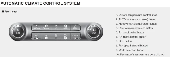

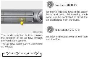

Try Pressing Button 9 on the image attached, until you see the Arrow horizontally facing the passenger.
