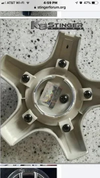

A433DA6E-A70D-41E1-9892-6B78CE5E982B.webp D8ECA777-88C0-4866-BAA9-0F97C9B2E632.webp
I got them from the Stinger Shop directly on this forum.The Stinger Shop at Kia Stinger dot com - We ship your order immediately!
So they’re screwed in? Interesting. Do you have a picture of the back side of the whole wheel cap by any chance?
It takes like 5 seconds to pop off the center cap and look. Go out to your garage and look. There are 5 screws holding the painted back to the fake center bolt/emblem. And 2 screws holding the bolt/emblem in place. All Philip’s if I recall. Nothing too difficult to disassemble.

The "bottlecaps" are removeable. In fact, when I had my center caps painted black to match the powder coat black, they disassembled the hub caps.

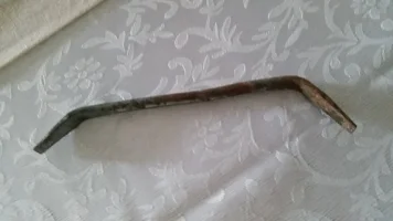

Perfect, thanks. Only reason I haven’t already done it is I’m at work. What’s the safest way to pop the wheel caps off?
It's an adjusting tool for old style drum brakes. Have since applied tape to all surfaces that come in contact with wheels. Much easier and safer the a screwdriver.
