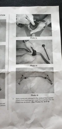

Each bushing has a grease nipple (zerk fitting). You will need a grease gun and silicone based grease (as originally supplied by Eibach) which is stickier than normal grease. The higher the car off the ground the easier to get to the bushings.

It's part of the installation procedure detailed by Eibach.
