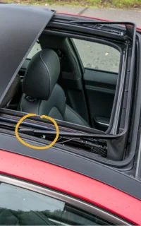

I suspect the bug catcher because when i wiggle the bug catchers right "leg" it makes a popping sound and the left one doesn't. I tried putting tape on it but it still pops. It is weird because when i completely close the sunroof cover the noises stop , like it presses the whole mechanism and it stops.
That's what I am not understanding from your description: you said that with the sunroof open you don't hear the noise; so the bug catcher with the "popping leg" isn't the culprit. Now, closed, I suppose that some distortion in the "mashed" bug catcher could cause rubbing and produce noises. But nobody, yet, has IDed the bug catcher as the source of their sunroof noises.
That is weird i agree. The circled part in the photo is the one making the sound when i move it. I just accused the bug net "leg" because the sound somewhat matched the sound coming from the roof. Now why does it not produce the sound once the glass is opened or the cover is closed i cannot say. I could be totally wrong because i don't know how would the sunroof that needs the rubber pads fix sound.

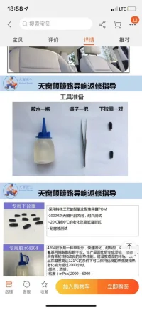

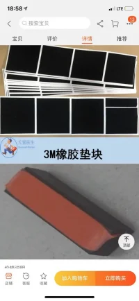

Before I drove stinger I used to have a Q5. The sunroof have same issue with you. There are sloution pack on Chinses Taobao(aliexpree) for $10, its basic a rubber with some "sponge", after apply to the " bug net "leg" "(a little bit future postion) it solved the problem for 70%.
You can try put two thin sponge for each side and move back/forward and test where is the best place, I think it could help and its cheap.
P.S sponge is black ,not yellow one, I didnot know the name of it

Is it something like this?
https://m.aliexpress.com/item/10050...f7aae1icavoe17885e54c101d79dc5c1186868&gclid=
