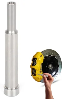

There exists a tool with hallow tip (so it doesn't slip off)
Use this, and just hit harder - it will definitely come out.
