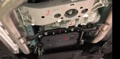

where is the transfer case on these cars?
Watch here:
- 0:15 seconds the rear diff is center screen
- 0:30 the cross member (gray) and transmission pan (black) are center screen
- 1:25 the front diff is center screen
If you freeze it at 0:32, from top to bottom you will see the big gray cross member (1), bottom edge of transfer case (2), a thin black cross member for the transfer case (3), and then the black transmission pan (4):
That's the plug I used to suck the old oil out, which was very dark after 100k miles, and put new in. Took just under 1 quart. 20240304_123239.png
