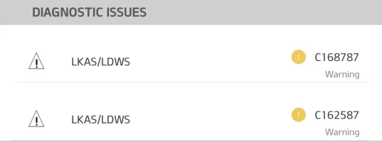

Took a screen shot of the codes the UVO app was providing

Since power resetting the system didn't resolve it, guessing speed sensor or power steering controller module failure (without looking at the codes).
Did you google the codes? It's always good to know in case the dealer tries to pull a fast one. "It was the hydraulic pressure release valve for your windshield washer reservoir".
From what I found it may have to do with an issue regarding the MDPS ECU. The dealership is short staffed and current only have one certified tech, so he wasn’t able to get to my car today. They did call and say my car will be the first one checked out tomorrow so we will finger crossed
