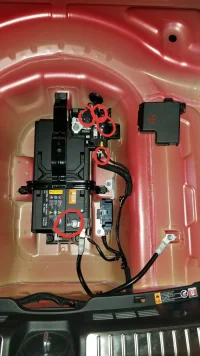

  3. Disconnect negative terminal of battery and tuck it under the drain hose so that it won't accidentally make contact with the battery again

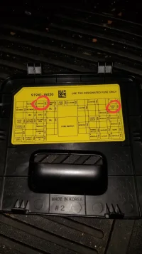

  5. (optional) Remove every fuse in the driver side knee panel labeled with 'airbag' for the same reasons as #3

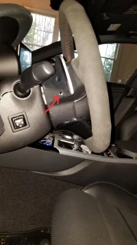

  7. Notice just next to your paddle shifters there is a small hole. Stick your flatblade screwdriver in each hole (blade parallel to the ground) and push. The airbag should pop out a little bit on each side

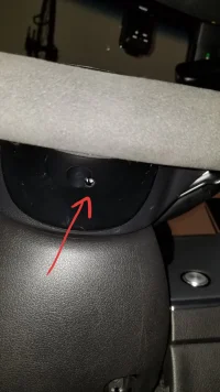

  8. Look on the bottom side of the lower trim piece of your steering wheel and you will find another small hole like in #7. Keep the same orientation of the blade and push the screwdriver in the hole. At this point the airbag will be loose

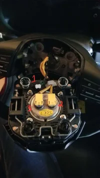

  9. The airbag is connected with 3 connections. First, remove the small one, then the pink one, then the purple one. I don't know if this order matters but nothing exploded on me

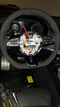

  3. Remove the 22mm center nut (easier said than done)
  4. Remove steering wheel
