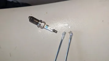

Had one blown when I went WOT on a highway merge ;) Basically shut my car down, threw plug code. Limp mode, turbos don't spool so you are on just normal engine power. I threw my stock nkg back in so i could drive. Cleared code via battery restart. Pulled plug had its ceramic cracked. #3 plug.

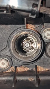

2 months later just about the same thing, but this time no code, but if I stomped it, car would buck and throw a fit and eventually limp mode, restart would make everything normal again but turbo's wouldn't spool anymore. Pulled #6 plug thats under the ITM (Sucks), then found ceramic had actually separated into plug shaft. So had to pull the ITM off completely.
View attachment 67562View attachment 67563
