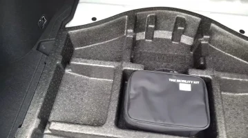

A5B035AC-FE47-4381-BC19-7DD89350A782.webp This is the European solution under the floor. I checken the space - it is enough -it is like in the U.S. cars.
But the transport and tax ? No idea - thank you very much for your kind offer -would be a great help
View attachment 5430 This is the European solution under the floor. I checken the space - it is enough -it is like in the U.S. cars.

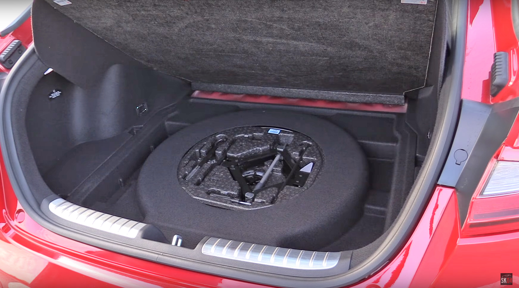

Here's the pic with the tire. Almost the same left-over storage space!!!! The cavern was clearly designed to hold a full-size spare and not much more. You are getting ripped-off in Europe regarding getting only the tire kit.

I am sorry I wasn't clear. What I meant above was that the design of the insert when you do NOT have the tire is almost the same amount of storage space as when you do. Hence my comment about firing.
If there was a great underfloor storage area, I would have been interested in swapping. To gain 2 L of space, no thanks.
