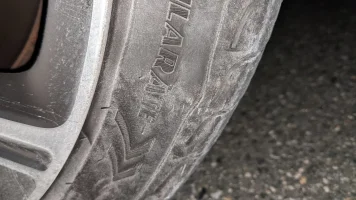

Have less than 7,000 miles driven on this car bought it used and tires replaced shortly before I purchased. just found a bubble on the sidewall of my front passenger side tire, not sure if it's manufactured defect or if something happened to it nothing really stands out in my mind that I hit but the roads are shit in Delaware. Either way, I know I need to get it replaced. what would the best suggestion be? change the tire immediately to the spare and ride on that until I can bring it to a shop to replace? also one shop I called said that they wouldn't put a different brand because it could affect the all-wheel drive, this is news for me as I thought that only tire size made a difference with the differentials. that being said, with the minimal amount of wear that's on my tires, would putting a new tire on just one wheel make any type of significant difference with how the all-wheel drive performs or affected durability? I would suspect no but does anyone see a problem with just replacing one tire or if there's a problem with one tire, should both front tires be replaced? Thank you

I would replace the damaged tire right aware. Nothing more.
I would only consider replacing both fronts if the non-damaged tire was down to 6/32" or 5/32"

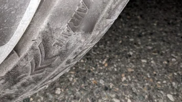

A little tough to see because of the salt but there's also a hole right on top of the a so it could potentially be a pinch but either way even though it's so small I'm guessing it should be replaced I have no idea when it happened I just found it yesterday.

Yup need replacement right away.
The sidewall is deformed (stretching), by those pics. As long as you stayed on surface roads and no more than c. 50 MPH, it is highly unlikely that the tire would fail outright any time soon. I wouldn't put the donut/spare on. Also, don't mix brands. The OD is only one consideration: the tread pattern is important. When they don't match, then the tires can pull against each other, building up tread heat and resulting in a blowout (ask me how I know). So, if your driver's side 225 is mostly new, there should be no problem replacing just the defunct tire with the very same kind of tire.

It's a 45K mile tire. The OP says there's ~7K on it, ~16% usage. If money super tight I think he'd be ok replacing one. Ideally both on the axle should be replaced. I don't think the circumference difference between front/rear will be significant enough to make a difference with awd.

Made an appointment on Mr.Tire.com and they did have the exact tire. 203$ installed, actually a pretty good deal. Maybe they have a daily warehouse drop-off or something‍♂️. Thank you all for the advice and opinions
